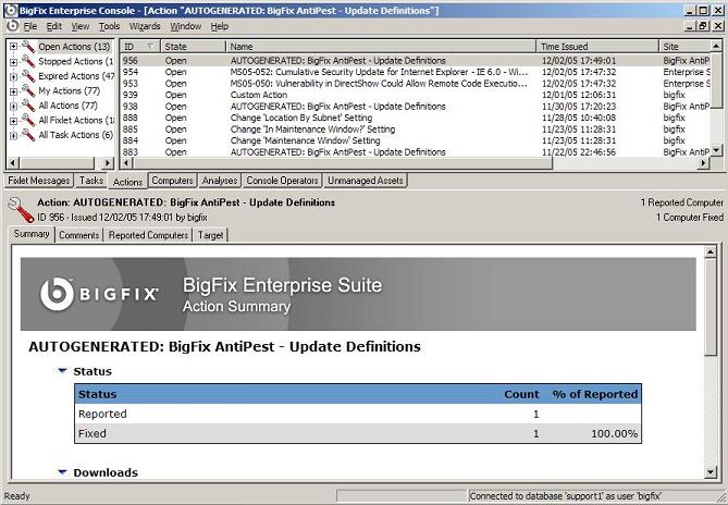

  1. When you run the BES Action Regenerator, it will create an action that will be targeted at all relevant computers for the "BigFix AntiPest - Update Definitions" Fixlet message (or whichever Fixlet message you specify). The action that will be created will look the same as if you opened the BES Console, clicked on the Fixlet action, targeted to all computers, and then sent the action out (the only difference will be that the action name will start with "AUTOGENERATED:").
  2. When you run the BES Action Regenerator again, it will look to see if the download has changed from the last time it ran. If the download has changed, it will send out another action that will include the new download.

    Fri Dec 1 17:46:16 2005: Running Script...
    Fri Dec 1 17:46:20 2005: SHA1 in action 1 of Fixlet 4 of site "BigFix AntiPest (powered by PestPatrol)" has changed! There is a new download available. Beginning action propagation...
    Fri Dec 1 17:46:20 2005: Starting action propagation...
    Fri Dec 1 17:46:30 2005: Action propagtion finished -- Generated Action ID: 956 in 10 seconds.
    Fri Dec 1 17:46:31 2005: Script Finished...
